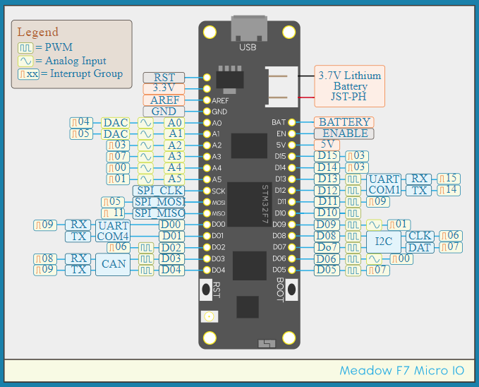

Important Note: whenever we’re working with Digital Interrupt Ports, lets check the Meadow F7 Micro pinout diagram below and pay close attention to the Interrupt Group on each pin.
Legend PWM = Analog Input = Interrupt Group usa RST AREF GND Al SPI CLK PI MO D02 APE F •GND • cock TX CART COW BAT • Dom 006 • 3 Lithium Battery JST-PH BATTERY ENABLE UART D12 COMI TX 12C DAT Meadow F 7 Micro 10
When you plan to use Interrupt ports for things like push buttons, rotary encoders and such, be sure to only use one pin per Interrupt Group. For example, you wouldn’t be able to configure pins D14 and D15 as interrupt ports since both belong to the Interrupt Group 03. The app will throw an exception informing us that Interrupt Group 03 is being used more than once.
Also notice that you can even configure the Analog pins as Interrupt Ports for when you’re not using them in your project.

From the pinout shown above, we’re wiring four push buttons that belong to different Interrupt Groups:
  • Pin MOSI belongs to Interrupt Group 05
  • Pin D02 belongs to Interrupt Group 06
  • Pin D03 belongs to Interrupt Group 08
  • Pin D04 belongs to Interrupt Group 09
